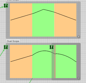

I was not hearing it. But the interpolation was not very good.
Doing an angle at the center...
Sorry, now i could see more clearly what it does with an array.
I make another one that's very similar and low cpu, but now there's angles at the edges...
interpolation test.fsm- (6.31 KiB) Downloaded 742 times

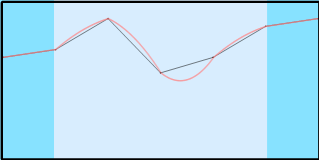

As intended, i tried some formula, but none was better than a cubic interpolation.
But even with this one i'm not completely satisfied with the behavior in some situation.
(even if others are perfect)
Here in red the result of the cubic one. But i want something like the green that i do by hand.
Do you know a way to do so ?
I find here the cubic interpolation : http://paulbourke.net/miscellaneous/interpolation/
(i just try and add the Hermite, but it only attenuate the bounce)
