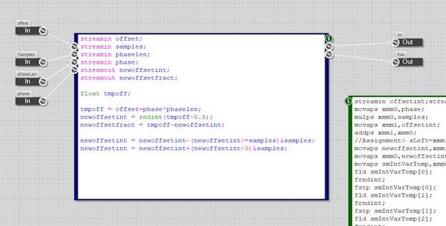

In the assembly with the int and frac out it says at the end:
movaps j,xmm3;
movaps jfrac,xmm3;
but should be:
movaps j,xmm0;
movaps jfrac,xmm3;

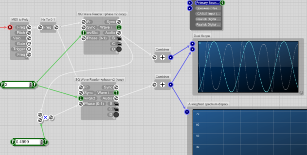

Maybe we just have to multiply the phase to get the wanted result ?
Here with X 0.49999 it have only one peak.

Well, in my own, stumbling, hunch-following, trial-and-error way, I seem to have figured this out.
Just putting this 'Add Phase' code from the iFFT osc between the original Razorblade osc 'Counter' and 'Interpolated Read' modules did the trick. Just needed to give the 'phaseLen' input a float of 168.562 (as in the iFFT), to set the Buffer Size, then the 'phase' input functions as expected.

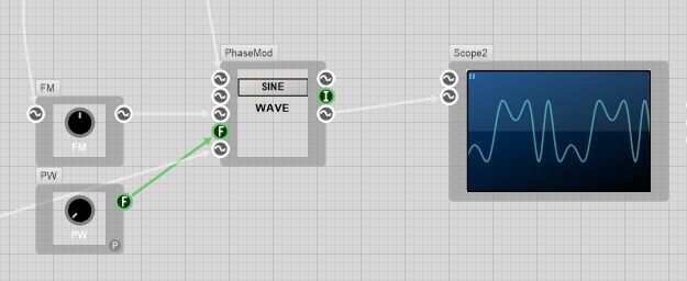

FM with two sines at Ratio 1:00 looks and sounds just as expected:

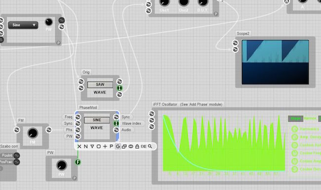

I think I’ve done it!
It behaves the same as Martin’s proper phase modulation on his sine osc (you can compare in the schematic).
MyCo’s version was good but it limited the number of “folds” you could get with phase modulation, which is why there were flat bits in the waveform at high modulation indexes. That was because his phase DSP went past the index limits at higher modulation levels; he only provided for one fold for plus and minus phase values.
The DX7 hardware used unipolar addition for the phase offset and I guess the wrap-around for folding was either done in the adder or the ROM reader. Maybe the adder only supplied the lower bits so the wrap-around would take into account higher modulation levels. The MSBs would be ignored, even though they still operated. Dunno.
My big challenge was to make it bipolar, so any waveform can provide FM without needing an operating point bias.
I also reduced the double precision counter to be fractional and the conversion to int & frac is done after my DSP phase code. The “High Quality” selector now works.
