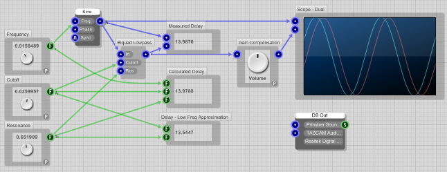

Here is a little test setup for delay estimation. A sine wave is fed into a biquad lowpass filter and compared against the original. The resulting delay can be measured by evaluating zero crossings. As you see, it may well exceed 2 samples.
I have also included a calculated delay from the real and imaginary parts of the transfer function. This may be a bit CPU intensive, so I have also thrown in a (much cheaper) low frequency approximation (which may or may not be sufficient).
I'll try to apply this to your (Nubeat7) schematic tomorrow. I see you have both a lowpass and a highpass in the feedback loop, so that's something to consider.

Okay so here is what I got so far. The lowpass delay compensation works quite well, octaves stay nicely in tune. I also checked with a reference sine tuned to the fundamental frequency.
However, I don't know how to go about the highpass delay. While it is possible to compensate the delay for the fundamental, the harmonics will in general be off because there is dispersion. This actually makes things worse when the highpass cutoff is above the fundamental. In that case it is better to disable the delay compensation.

thank you martin, it works great with the lowpass! it sounds much better now
as you said with the HP it is better to leave it..
