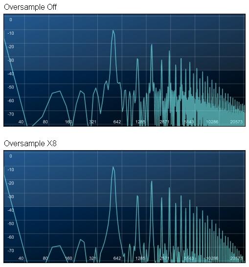

OK, this might be the finished product. I've also written a manual that describes how to safely use the module and how to modify your schematic to work with it properly. I would appreciate if someone could do some tests to confirm it is working on different systems. Also I accept suggestions and criticism, especially for the manual.
Oversampled Module Manual.rar
(1.8 MiB) Downloaded 2177 times
oversampler_v4.fsm
(244.39 KiB) Downloaded 2152 times

Actually, it was almost suspiciously easy. The schematic worked on second try! (first time it crashed, as usual with ASM). I would really love you people share some schematics where this module is put to use. I currently don't have any project taking advantage of this...

unknown as of yet. It will probably not be compatible with 64bit version, but fix should be very easy to do (literally the only difference in operation will be the size of the address and corresponding variable - 64bit instead of 32bit). Though that is probably true for any Assembler code that touches pointers.
The only possible problem may arise if, in future versions of Flowstone, there are changes to how Ruby component operates or how streams get compiled.
As for whether this is safe to use, the manual goes into meticulous detail about how to modify your schematic to ensure safe operation. Generally, if a device can run any flowstone-made software it should have no problems with this also - it literally just implements for-loop that spans multiple modules. Tests so far reveal no issues... if you experience some, please report them here or PM me ;)
