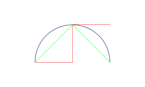

I hope it is ok that I make a visual explanation. For me that's the easiest way to describe it. In the image, the assumed original waveform is drawn in blue, red would be the result of sample and hold, while green is linear interpolated and what I'm trying to achieve.
However, it really was just an example to the topic of how to deal with tasks that require a buffer, introduce latency, etc.
