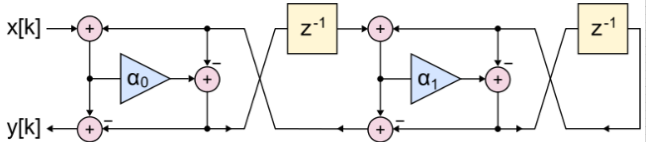

Just find this other way to make an allpass.
It's a wave digital filter, but in this case it change nothing..
This is because the signal is separated in 2 in a way that recall how a current would travel in a circuit.
(but most allpass are like this.. not sure i understand all with this classification)
The main improvement is that we only need one multiply by allpass order.
The coefficient here might be from 0 to 2 and not -1 to 1.
2th allpass (Wave digital filter).fsm- (43.54 KiB) Downloaded 3095 times
- WDF Allpass.png (27.82 KiB) Viewed 164739 times
