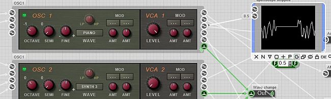

I kept hearing an odd couple of notes jump out with the PIANO wave, so I checked on a scope and found that for just a couple of notes around the middle of the keyboard, the wave has a considerable gap (flat line) in the waveform, that is very audible as a bright zing in the sound. I checked SQ8L and it's not there.

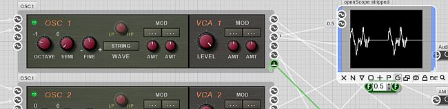

Also found it in the STRING wave, but for that, the flat spot is only not there for about the top octave.
I'm pretty sure both those waves were samples; maybe a connection?

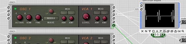

Considerable flat spots in REED2, but that's probably an additive wave and they're supposed to be there.
But PIANO and STRING clearly have something going on. I fear there's a ghost somewhere in the DSP.

k brown wrote:I kept hearing an odd couple of notes jump out with the PIANO wave, so I checked on a scope and found that for just a couple of notes around the middle of the keyboard, the wave has a considerable gap (flat line) in the waveform, that is very audible as a bright zing in the sound. I checked SQ8L and it's not there.
Also found it in the STRING wave, but for that the flat spot is only not there for about the top octave.
But PIANO and STRING clearly have something going on. I fear there's a ghost somewhere in the DSP.![]()

OMG! Going back to such a complex synth was quite a shock to my poor old brain, but I found the issues.
Each multi-wav “wave” has custom DSP code to tell the wav reader the sample size according to which wav is indexed in the wav array. I called that index the “Tag”. Turns out I’d made mistakes in the Piano and String DSPs, giving 512 instead of 1024 for example.
In fact the Reed2 was fine and you can tell because the waveform is never flat.
When I was testing the Piano, I found the transition from B6 to C7 (top of the 5-octave keyboard with C4 being middle C) was truly dreadful. It changed from a nice high note to a vile sawtooth with aliasing. So I checked the original spreadsheet we used and that was correct, according the table. It could well be a mistake when the table was created, so I took the liberty of changing from a nasty sawtooth to a much more pleasant “more aggressive sine.wav” and to my ears the transition is much improved, to the point where it sounds almost continuous.
I’ve attached the updated schematic. If you can confirm there are no more nasty surprises in store I’ll update the zip download and publish it, and the update will be a good excuse for reminding people about it.
