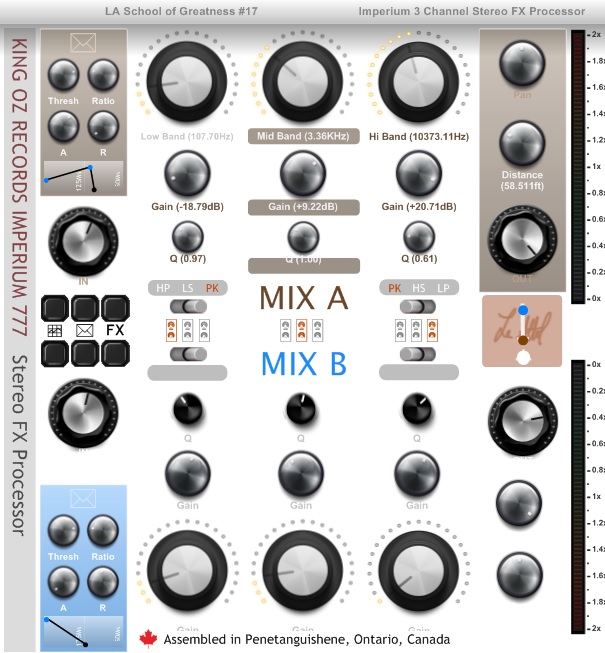

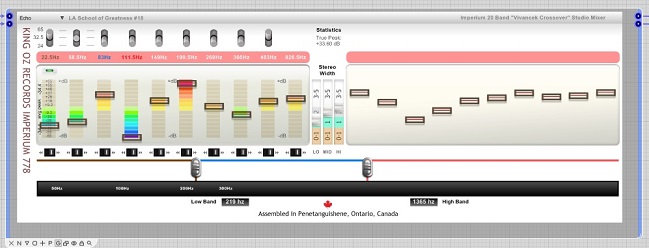

I recently used them in a new product I'm working on called the TQ:
TQ EQ (Thanks to Loopeytunes for Knobs):
Imperium 778 (20 Band Vicanek Crossover) Thanks to Loopeytunes and Nubeat for GUI Elements
Imperium 777 Processor Thanks to Loopeytunes and Nubeat for GUI Elements:
