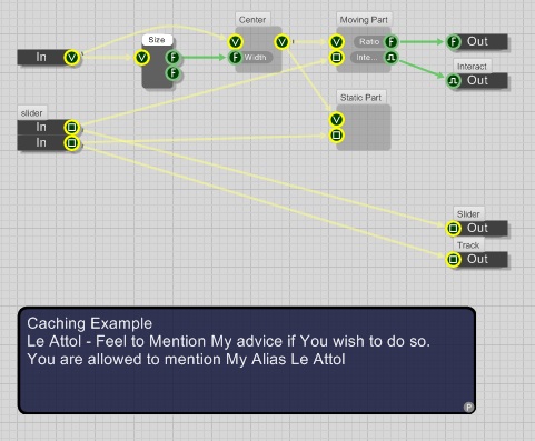

Furthermore to make image caching in HTML and CSS, all one has to do is to have a hidden element with the images
to be cached inside. Think to Yourself; Is that not unlike the preview modules?

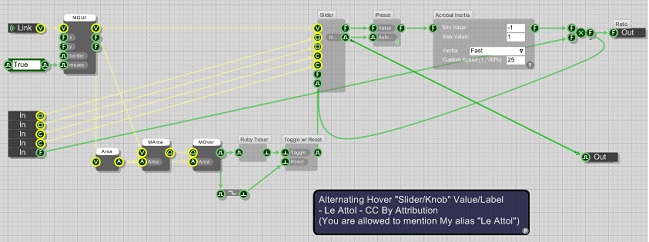

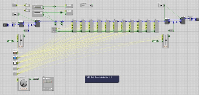

It was only after trial and error that I had come upon this and I thought I would share that; But to also provide a tip regarding optimization I suggest You make sure to use the same image for many knobs that are the same type. All of My plugins are 2%CPU
or less and I know that might make Me seem kind of old school, if You really think about it - The good plugins are the ones You might
use 20-30 times in a track. And that is when CPU Saving becomes so prudent.
Here's some screenshots depicting that:
