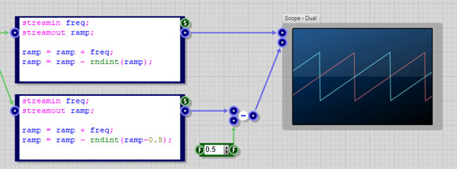

Re: Useful Tip: De-Zippers and result of Multiplication
Umm....no?
If you have a ramp that goes from -0.5 to 0.5 and 0 to 1 then subtract 0.5, you just push the phase of it by half a cycle. There is no difference in sound quality, like the OP says.
