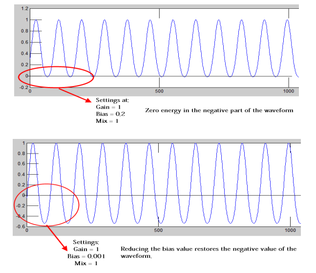

It still seems not right. I have too much "gain" and the phase seems wrong too.
the original function is:
y=sin(x)+(abs(sin(x)))^8-z
I have added the schematic. And a picture of how the sinewave should look like.

te provided image definitely doesn't show the graph of function you've written. check that with this plotter, It will output the same kind of wave like your schematic:
http://rechneronline.de/function-graphs/
and input "sin(sin(x))+(abs(sin(sin(x))))^8-0.01" (the inner sinuses are there to simulate a sine wave input)
You will see that your schematic shows the same graph as this function. Basically you've made perfectly the function you've written above within the code component.
It is possible that the user used different input wave, but unlikely. There must be something more in the paper that they've done with the signal, because the function and graph definitely doesn't match if input was sine.

thank you. very good link!
I have found something in the matlab code:
there is a point before ^
sin(x)+(abs(sin(x))).^8-z
i found out that is something like element by element calculation. but where is a matrix or so ??
