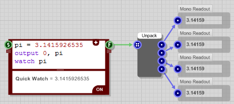

tulamide wrote:Ruby's pack method is not the same as Flowstone's pack prim. In Ruby, .pack is just a format converter. You can get a string of 4 values, but the string is not guaranteed to be contiguous in RAM, nor that its address is divisible by 16, etc.
Ah, I see. Probably the issue is not so much about generating the 4x32 bit sequence within the Ruby module but rather about getting it out transparently. We have only a small set of data types that we can use for Ruby output, and there is some implicit conversion taking place. For instance a green float output will provide 4 copies in single precision (even though internally floating point numbers are represented in double precision).
martinvicanek
Posts: 1334
Re: Packed data in Ruby?
Postby tulamide » Sat Nov 28, 2015 2:37 pm
martinvicanek wrote:Ah, I see. Probably the issue is not so much about generating the 4x32 bit sequence within the Ruby module but rather about getting it out transparently. We have only a small set of data types that we can use for Ruby output, and there is some implicit conversion taking place. For instance a green float output will provide 4 copies in single precision (even though internally floating point numbers are represented in double precision).
Yes, Ruby uses whatever the system provides, for example double precision floats. But Flowstone uses single precision in green and therefore converts any outputs from Ruby to green. I think this is also documented somewhere in the manuals.
To get a series of 4 different values in a certain format, you have to use .pack(), just as you assumed. But, the result will be a byte string. This string is a bit like the mem prim, but Ruby does not take care of the contiguous data requirement, etc. So, you have a byte string, whose content may be in different locations in RAM. That invalidates it for use in the unpack prim.
Btw.: The green to unpack link is a convenience, too. In the background Flowstone does a conversion of the data (it reserves a contiguous memory block with an address divisible by 16, then copies the float 4 times to that mem block, and finally passes it to the unpack prim)
I really don't see an easier way than the one we already did. It is all there, just the block of memory (in Ruby it is a "frame") must be reduced to 16 bytes, and the input single values instead of arrays. You then get the memory address that you can access from assembler
