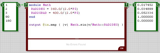

Postby Lex248 » Tue Oct 18, 2016 9:56 am
With RAD2DEG and RAD2GRAD module.
sin_array_1.fsm
(486 Bytes) Downloaded 1494 times
sin_array_2.fsm
(534 Bytes) Downloaded 1490 times
Sorry, I bad speak english.

Re: Process an Array in Ruby
Postby OllieMarshall92 » Tue Oct 18, 2016 10:26 am
Thanks, both of you.
My input is in degrees, how do I format it so if I put 180 in I get a 0 out? e.g. sin(180) = 0

Postby Lex248 » Tue Oct 18, 2016 12:42 pm
My plug-ins http://nalexsoft.blogspot.com/
