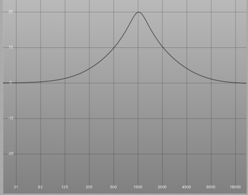

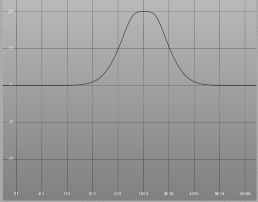

I had a little DSP excercise which kept me busy for two weeks or so. The objective was to create a bell-shaped filter which is more concentrated around the center frequency than the common RBJ biquad, but at the same time has a flat top. This is what I came up with.
biquad EQ.png (18.44 KiB) Viewed 18338 times
4th order EQ.png (17.49 KiB) Viewed 18338 times
The schematic includes a 5-band demo equaliser (stereo, optimized). Feel free to use, integrate into your projects and modify if you like.
