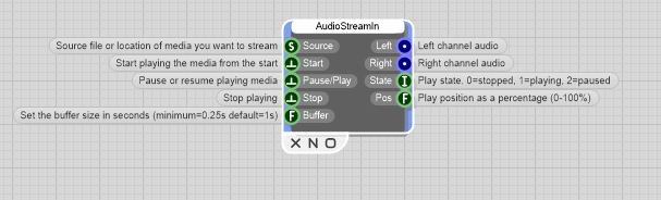

I was hoping someone may have done this before in Audio with the "Audio Stream In Module".
Check out this module, it can capture Audio from a remote location, then your second machine can process and play it.
StreamIn_Module

Thank you very much, interesting idea. But how can I make/establish that one computer transmits sound to IP address please? (what exactly I should do?) and what to add as source file or location input - that Ip address ?
Thanks a lot for info.
