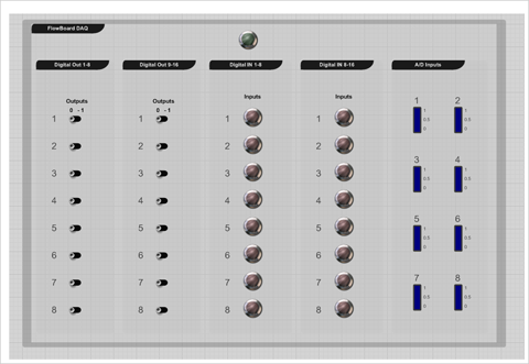

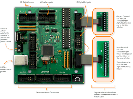

This example is to test the FlowBoard DAQ.
There are LED's to indicate the state of the 16 digital I/P's, switches to change the state of the 16 Digital O/P's, and meters to indicate the analogue level of the 8 analogue I/P's.
