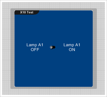

In this example FlowStone sends out the X10 commands to the Marmitek CM15 Pro USB X10 Controller to turn a simple lamp on and off from a switch on screen.
The lamp address is set to A1
X10 Commands used are:
A1 on
A1 off
Simple!
x10 Lamp Test clip.png (25.13 KiB) Viewed 46127 times
