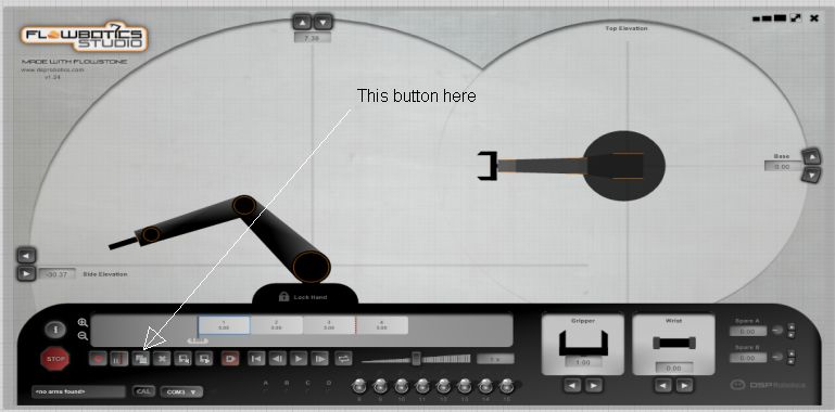

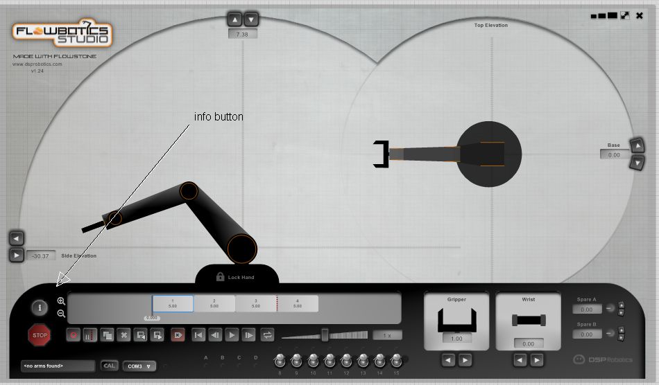

I have attached a picture of the Flowbotics studio screenshot.
First off there is an "i" button, on the lower left that turns on information for all the buttons. This button is shown in one screenshot.
The second button, the COPY button, shows two square boxes together, is what is used to create new positions. This is in the other screenshot.
Click this for however many transitions you want. Once you have 4 boxes, for example, click on the first box in the timeline. The arm will move to it's default position. Next position the arm and other axis where you want with the mouse or arrows. Once you get it where you want, click the RECORD button (small round red button) for save. Next, go to the 2nd box that you added by clicking on it. The robot arm will again move to the default position. Again, repeat these steps for each box that you added. Now all the positions are in the sequence, and you can hit PLAY
When you are done, to save the sequence, press the Save button (button with the disk symbol with the arrow pointing toward it). Select a filename and save. Now this saved sequence can be reloaded by clicking on the LOAD button (disk button with the arrow pointing away from it) to load. Select the previously saved file, and it should now show the saved sequence in the time bar. Clicking on the play button, the big arrow right button, will transition through that saved sequence. Editing a position is simple as clicking on that block, moving it to a different spot, and clicking the save button again.
