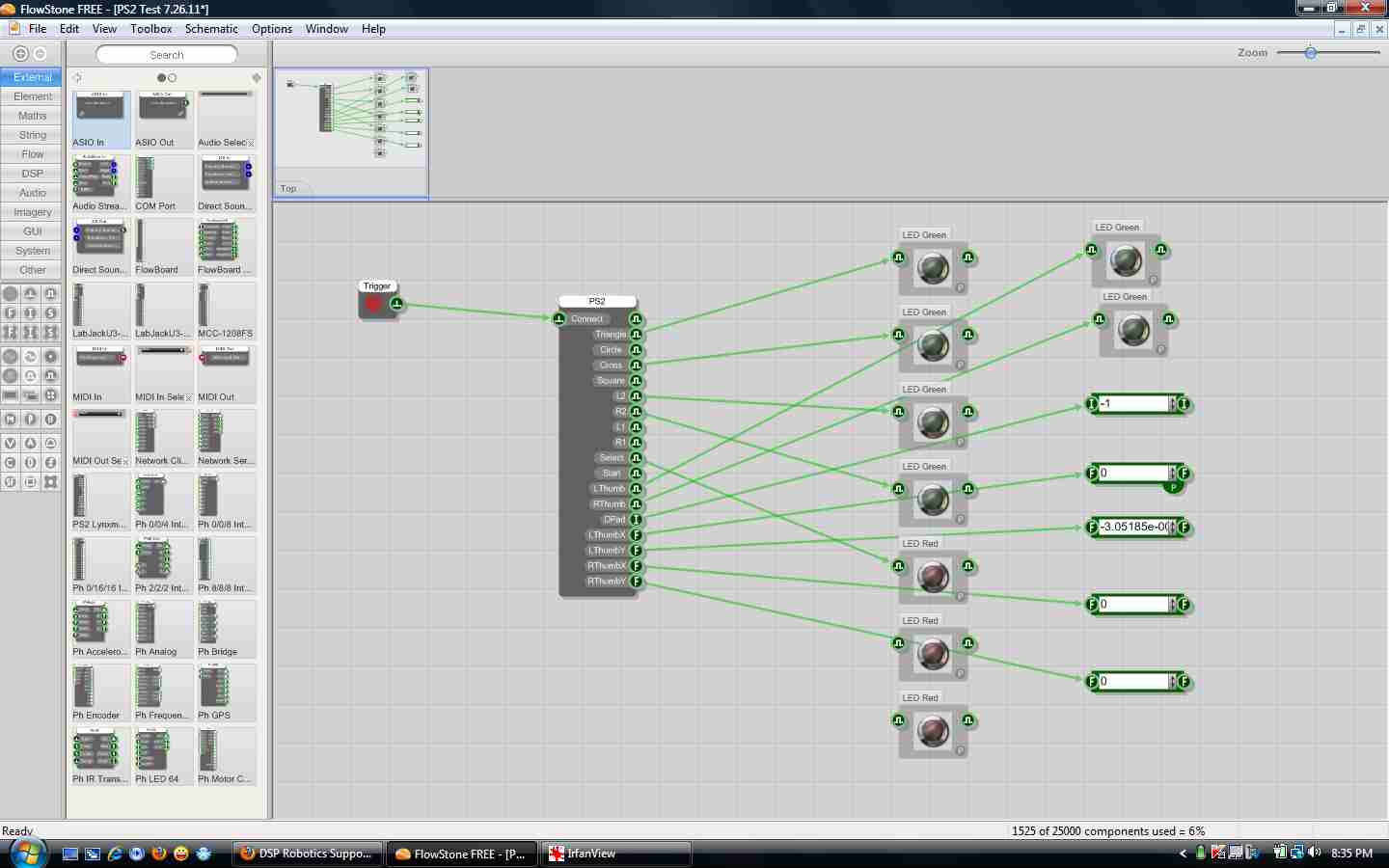

1) Left thumb Y-axis constantly reports noise jumping all over the place (see screen shot). Once I deflect the joystick a little either way - maybe 10% - it then quiets down and gives a normal reading. Once near neutral, it goes nuts. The other three axis are fine.
2) Both L/R thumb X/Y-axis swing fully from -1 to 1 with only about 50% joystick travel. So from neutral to 25% forward deflection gives a full reading of 1 and from neutral to 25% rearward gives a full reading of -1. This is a bummer because it severely limits the range of motion. Is this a hardware or software problem?

One of the channels is mostly noise and crap jumping around. See the pic I posted.
Is there any way to determine where the fault is coming from within FS? The 4-joystick channels look fine in the Lynxmotion calibration software.

- The OP mentioned the 'wild noise' from one of the analogue controllers. I've seen this too - but usually the numbers involved are incredibly small (in the screenshot you can see the 'e-xx' indicating a number too small to fit into the number of decimal places). Creating a small 'dead zone' around the centre that will send only 'zero' messages sorts this out; so that only deliberate movements of the joysticks send anything out.
