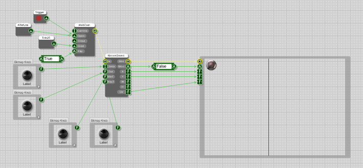

In this example we show how to make an alarm system out of a webcam using motion detection and two zones left and right. motion on the left is ignored (one side of the fence) and motion on the right raises and alarm (led):
Motion Detection Alarm clip.png (38.4 KiB) Viewed 68024 times
