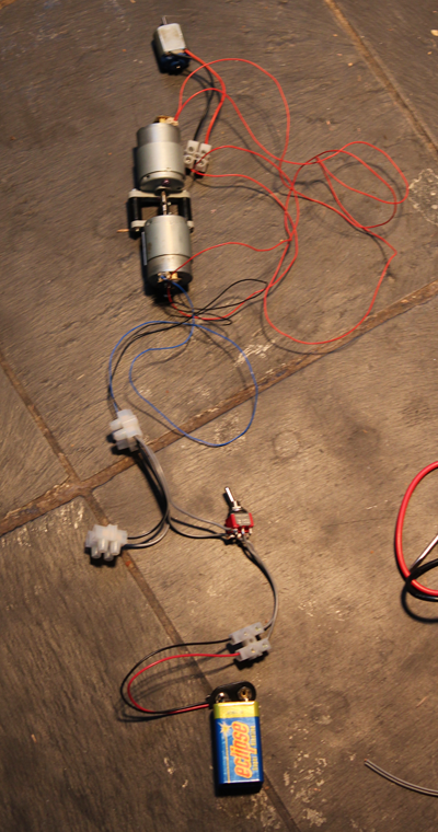

Re: Let's automate everything hehe(interfacing PLCs+)
This is part of the circuit I have. This photo demonstrates that DC motors generate DC.
It reads bottom to top.
So the tiny motor at the top wants to spin, and does.
It doesn't spin wildly back and forth, and trip out like it would with an AC signal.
It spins quite nicely in one direction, and I suggest it is receiving DC.
All (edit) 3 motors are DC.
This goes against conventional knowledge and I am confused.
I have built the diode bridge and I like it.
It means my generator motor isn't receiving power from the battery,
only the mechanical couple from the drive motor.
It still doesn't work, the voltages/current don't sum.
Cheers!
You can see my parts in the photo, Jay.
The coupled motors are essentially the same unit.
I think they would run for an extended time at 15volts,
maybe not at 18, but would handle a short wattage spike.
They are out of a printer probably.
The diodes I have are 40 watt Shottke ones,
they have and impedance of .5 v, and leak .5 v

Those are permanent magnet DC motors. The armature (the part that spins) generates a magnetic field that interacts with the permanent magnets and causes it to spin. The relationship of the brushes to the magnets sets the 'timing'. People that have raced remote control cars know all about this. On racing motors, you can actually adjust the timing to get peak RPMs out of the motors. Just like with gas engines, there is a point where you have advanced the timing too far and the RPMs go down while current goes way up. Also, if you look at the current to the motor, it is at it's peak when the motor isn't turning since a DC motor, which is basically an inductor has the impedance of the wire which is very low until the motor starts turning.
All motors definitely are not DC. Most motors that I run into for industrial purposes are AC and are brushless. With the brushless types, there is basically a rotating field around the armature which induces a field in the armature and eventually gets it moving, then you can control speed with the frequency of the field.
Also, there is typically some sort of circuitry to control the excess voltage that is generated by the motors when they coast to a stop, that's how some of the braking works on electric cars but instead of being dumped to a big braking resistor, it's dumped back into the batteries. If you short out the output of your generator motor I'd expect the main DC motor to either slow down or start drawing more current.

Sorry mate,
you misunderstand me,
all 3 of these motors are dc,
not all electric motors are DC.
Yeah mate, I am seeing this loading in these little motors,
it's bringing them to a stop in a half-dead 9 volt battery.
I'm seeing the spin slow to a stop, not that I have set the polarity wrong.
I'm still struggling to understand all this.
No-offence meant on my part,
Jay, you,Maik and MHz have the applied knowledge-
I can't understand why my generation seems to be DC--
will read your post again.

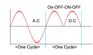

your question about the dc output of your motor, it is indeed dc! it works like this, an ac current is produced by the rotation of the armature (Coils) through the opposing magnetic fields of the permanent magnets, thus an ac current is induced, a sine wave, this ac is then passed to the commutator that is made up of copper strips soldered to the ends of each of the windings, these strips are isolated from each other, the commutator spins with the brushes making contact with the commutator segments which switches the current on-off-on-off-on-off, continuously, each on-off is performed over one half cycle of the sine wave (one half rotation of the coil) or twice per cycle, here is a drawing (forgive my crude photoshoping
so the latter half of each full sine (Negative) is chopped of leaving a half wave, On a purposly constructed DC generator, many coils switching in this manner around a commutator with many sections, pushes a great many half wave pulses out into a steady usable direct current stream! man im rubbish at explaining things!

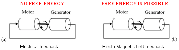

ok well what i discovered was the signals don’t sum by the methods you are attempting, (similar to my first efforts) as they are rather different, i.e the frequency of the dc out signal is different to the dc out of the battery or supply! this is due to the interaction of the split ring commutator segments and brushes plus the rotational speed of the armature making up its output freq, also if you are able to look at these two signals (dc batt - dc gen) on a scope they look very different, so what i was told was the two dc signals need to be made the same to be summed as one signal of greater current, this can be done by means of a regulator circuit like a simple buck boost convertor on the output of the gen and input switching circuits ie, switching between stored gen output (capacitive) and battery/supply input!
Your setup! I’m pretty sure your printer motors are 12v dc, and a little bit much for a 9v battery, try getting a hold of an old pc power supply or some decent 12v batteries to do this bud, they are most likely rated at 9 -14.5 volts, 0.5 amp motors, so you want a good current supply to the motor to produce the required torque to turn the generator, what you are getting with the system bogging down is the load being applied to the generator which results in back torque, eddy currents and B fields in the generator that manifest as drag, requiring more torque from the motor to turn the generator and pump out the current! you can test this out by simply attaching say an led or resistor of some sort to the output of your generator whilst it is running open voltage/un-shorted (without gen to motor feedback loop) you will hear the run motor change speed and slow down as this load is applied, when this is happening your drive motor is pulling more current from its source to maintain its own rotation and in turn rotate the generator with a load
so, in the closed loop scenario the output current from the generator is looped back to the drive motor but it is less than the additional current required to run the system with the extra load imposed by the generator, don’t forget that a regenerative system of this nature is put in place to recapture waste energy from a system that is already doing work of some form and already has a load on the motor, a regenerative system would recapture its energy from conversion of waste kinetic energy or capture of energy from the environment whereas this setup costs more than it converts/generates! Since the motors are not 100% efficient there are losses right from the start, the generator is very inefficient and adds greater losses in the form of drag and consumption so you see the catch 22 that many great inventors have tried to overcome!
This drag force from the generators is exactly how regenerative braking works in a car, when you apply the brake it engages 4 generators through gearing, these are connected to the load (batteries) and the resulting back torque slows the car down.
some AC induction motors actually speed up under load which is quite strange! microwave fan motors do this!
so can this be done make an efficient motor gen? Yup but not by doing it with matched dc motor/generators! unless you do this
an ac generator is constructed virtually the same apart from the means of current collection, its commutator is in the form of solid slip rings that output the full ac waves
