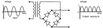

well you dont need a full bridge on an already dc output, a bridge is used to take an ac signal and convert it over to a dc signal! see image!
you would want a full bridge rectifier on an ac generator and it is the most common way of converting ac to dc in our everyday electronics!
by using a full bridge to re- rectify the dc output of your motor/gen you are causing losses in the form of voltage drop of all the diodes! it is however behaving as you think as a valve but you only need one diode
to set up a blocking diode you place one on the positive output of the generator to stop backflow of current from the load/battery! you also want a capacitor across the output to smooth the ripple from the dc, i would use a 25v eletrolitic.

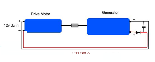

This is what I propose->
Do you have a scope Jay?
edit- That's really cool u r doing this too!
So another way to look at what I mean with the feedback,
apart from summing- which is what I've been calling it-
is running two power supplies in parallel, one of which is some 1 volt lower at 9 volt scale.
I did something which may have been unwise, sorry people,
but thankfully my aa batteries didn't malfunction.
I plugged a 3v power supply in parallel, with blocking diode.
It had the same effect as my generator motor-
it couldn't force the diode open.
So how do you sum or run these 2 supplies in parallel?
I think I got the wires the wrong way around in the feedback drawing,
oh well it's fine to do that for a short time at low wattage hehe.

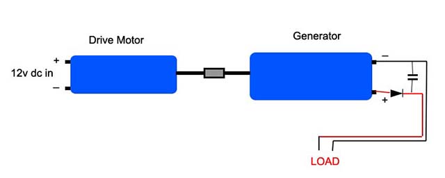

Re: Let's automate everything hehe(interfacing PLCs+)
Well, we seem to have turned up DC generation from dynos-
whatever that means in all practicality
- so that's good.
Jay has only shared the volts, so I dunno if there is anything in the em field idea.
Using 3 directly coupled motors just seems wrong to me,
I'm tossing up wether to plug it in with a switch to load the generator and impel a smaller driver.
It's not going to do anything, but hey- I made a model and kept busy.
Mhz man, do you think if there was some theoretical way of summing the generation voltage and
input supply, would the device respond by speeding up and continuing to do so?
I mean- i'm guessing it would just load and bog down the generator or not?
Is this a waste of time- or can you see what I'm thinking working?
You don't have to coddle me, I know this kinda thing is physically impossible.
I want to sum electronically- with DC constants, so nothing is lost to inefficiencies wherever possible.
I am willing to take the 1 voltage hit for diodes and the like- as long as it feeds more current
to the generator driver pins than the supply by itself.
