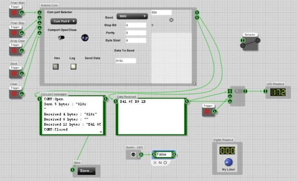

This is the continuation and on-going experiments with using Flowstone to develop a auto vehicle OBDII monitoring and diagnostic tool. Original thread is here: viewtopic.php?f=2&t=2886&p=15568#p15568
I have mocked up a initialization schematic using a time, counter, and selector to send commands to reset the vehicle OBDII communication, read back the ELM version, and select the protocol. I will expand that to then poll the OBDII for various readings and convert the OBDII hex values and display them in readouts. However, I got tired of working on the Flowstone schematic, then having to go out to my car, connect the OBDII adapter, connect through Bluetooth, then tryout the schematic. Looking for an off-line OBDII emulator, I can across OBDSim by Gary at http://icculus.org/obdgpslogger/obdsim.html
I have installed and set-up com0com and OBDSim and successfully obtained communication and read back the simulated temperature reading. However, after I send the first PID 010c command for the temperature, I can not get any additional readings so I only get the first reading and then the OBDSim just bounces back my command of 010c.
Anyone had any experience with using OBDSim and com0com for virtual com ports?
Please Note: Further updates to this project are further down on this thread

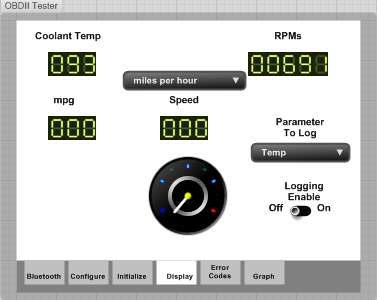

Here is a update on the project.
Again, still having troubles trying to use OBDSim and com0com as emulator. However my OBDII Tester works fine with the bluetooth adapter and while in the vehicle and responses at least as far as my initialize scheme goes. However, I have encountered a problem when trying to poll the OBDII for readings. When the PID is first sent, the OBDII responds with "Searching" , then sends a hex value of the reading. My timer/counter idea for polling the OBDII for parameters therefore does not work since it sends PIDs sequentially before receiving the searching and actual value is sent by the OBDII. Therefore I need to rethink this approach or have a way that times the message received and sent properly.
I have just a basic GUI for now, opting for a tabbed window approach. I still need to finish the bluetooth connection tab, the error code tab (just copy of bluetooth module as place holder for now), and fix the send/receive timing issue. Also it appears that the <CR> control character is being sent twice each time.
I know this could probably be done all in code easier and more efficiently but I just wanted to work with what I had to start. The work goes on.

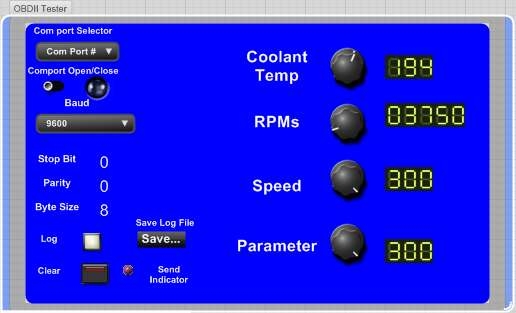

While working on this vehicle OBDII tool, I got frustrated with the OBDSim not working correctly so I could check/test my work off-line (not connected to vehicle). Then I realized why not create a OBDII emulator in Flowstone. Below is my start at the emulator. I tested it with hyperterminal and can achieved connection and response back in hex. Still having trouble with receiving back a "<" prompt properly and changing the knobs for the virtual vehicle parameters cause it to send data without a request. However,it has a lot of potential and should be fully expandable to any virtual vehicle data (O2 senors, VIN, etc.). Someone might find this useful for their projects. There is probably a much better way to do the logic check portion of the schematic.
ComPort_OBDII_111614_OBDSimu3.fsm- (372.48 KiB) Downloaded 4192 times
- OBDEmulator.jpg (71.78 KiB) Viewed 1198702 times

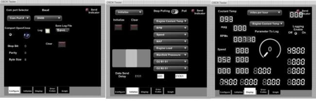

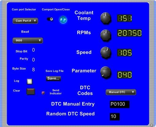

Here is a slight update to the OBDEmulator with DTC codes P0100-P0199 with either manual entry or a randomized output.
Below is a capture from communication with hyperterminal as example

ComPort_OBDII_112614_OBDSimu5.fsm- (378.32 KiB) Downloaded 4136 times
- OBDIITester_graphic3.jpg (88.76 KiB) Viewed 1198642 times

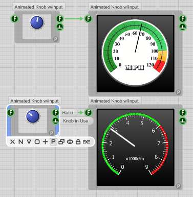

Making Gauges
Personally, I am not very good at graphic design. However, I wanted to create some gauges for the OBDII tool. I started by looking at lots of tutorials on creating them in Photoshop, Illustrator, Paint.Net (which is the graphics editor that I typically use). But all seemed very long with many steps. I therefore looked for some tools to download or use on-line. I came across the templates of gauges at various auto websites, that I yet to try and work with. I also came across the website of a company that lets you customize gauges on-line to see what they look like before buying:
http://www.speedhut.com
You can make some cool looking gauges, however they are copyrighted. You could use it to get some ideas though and create your own in a graphics editor.
Then I found a free program called Scalemaker Advanced on the X-Plane simulator forum website:
http://forums.x-plane.org/index.php?app ... wfile=2754
You do have to register (free) to be able to download the program. I used it to create a rpm gauge. However, it is pretty basic.
Next I found a website similar to the speed hut that lets you create gauges on-line and then download/copy the png graphic created:
http://www.optixl.com/gauge/
The intent is for use in reports or dashboards, not really auto style gauges. However, I created a mph speedometer graphic (left out the needle). You are allowed to use the created graphic for free.
I then used Paint.Net to place a large dark, thick ring around it and re-sized it. The ring helped hide the bad edge aliasing from the created png gauge graphic ( I tried lots of other things but this seemed to work the best so far). This is brought into the Knobman software and a stitched image is created with a just a line for the needle added. This can then be placed into the animated knob in Flowstone.
I have attached a couple of examples.
