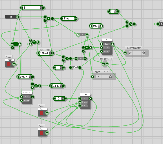

For some reason, this circuit caught my interest ... but I've not figured out what its' suppose to do
Will we ever learn more ? and the final circuit ?

RJHollins wrote:and the final circuit ?
You asked for it...
All this just to learn how inaccurate the peak detection is when it's coming off a mono to float.

Re: Can someone tell me why this doesn't work?
hmmm ...
well ... I was close on the 'peak' idea
Not good to hear about the inaccuracy, though
Thanks for posting the schematic pix. Would take some time to 'trace' it all though.
That whole thing is just a mess to take a "max" peak value and hold it for a bit before gradually releasing it. It's probably garbage code so no sense trying to analyze it... though it works. The inaccuracy comes from a mono to float after the actual peak detection (not shown here) pulling it back into green.The mono to float only ticks off at 100 times a second, so it's naturally going to miss a lot of values when audio rate is going at 44,100 times a second. With normal visual meters this doesn't matter since your monitor is limited to 60 Hz anyways, but for what I'm trying to do here I'd need to go back into blue to do this accurately at sample rate. I just wish DSP code supported extra things like "ifs" so my simple mind could stick to simple things rather than having to look up how to do bitmasking and such.
I completely follow you.
I guess the proverbial question ... is RUBY capable of processing at samplerate ?

- Posts: 1571
You could go at 1000hz instead of tick100 with Ruby custom ticker if u wish.
Perfect Human Interface wrote:That whole thing is just a mess to take a "max" peak value and hold it for a bit before gradually releasing it...
streamin x; // signal
streamin t; // reset time in samples
streamout y; // max signal
float i,xMax;
xMax = xMax - (i>t & xMax); // reset peak after t cycles
i = i - (i>t & i) + 1; // increment counter with reset to 1 at t+1
xMax = max(x,xMax) ; // retains former peak unless new peak or at reset
y = xMax;
Haha, thanks oddson. I could have sat down and figured it out myself but here you are making me look bad.
The whole masking thing is just slightly abstract so I forget how to do it.
