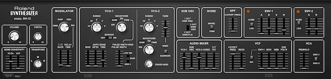

Before I'm off for a week's vacation - here's a new one, not in the Bundle. But this baby arrives in the world automation-ready: Rolend SH-12. A mash-up of the SH-1 and SH-2. This is the 2-osc synth Roland should have released after the SH-1. All the features of the SH-1, but with the second osc and it's associated features. Why they released such a crippled synth as the SH-2 is beyond me.

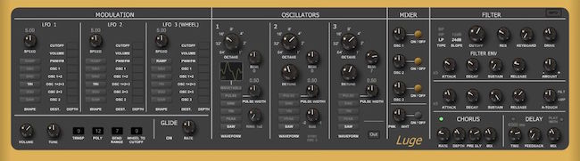

~StudioLogic Sledge:
Luge copy.JPG (32.49 KiB) Viewed 31937 times
