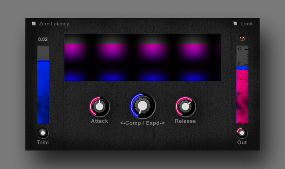

Lots and lots of drawing, maybe even per-pixel. On a related note, I've often thought it would be cool to have different blending modes like you get in Photoshop. Although all this fancy GUI stuff won't make your plugins sound better... Actually, I take that back. The mind is influenced by many things. ;)
Even just transparent png overlays can do great things for GUI designs if you know how to work them though. The dynamics processor plugin I made turned out kind of neat. And things like this look great in motion.
