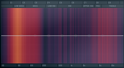

Not sure what will come of this but I'm just going to open the discussion.
Something approximately along the lines of this:
PEQ2 Spectrum.PNG (139.72 KiB) Viewed 24749 times
Would be wonderful to have in FS. I find it to be FAR more readable than the typical line-graph style FFT for most practical applications.

Do you think something like this that's efficient enough and fairly accurate is feasible in FS? It's kind of frustrating that the line-graph style FFT is so easy to piece together in FS yet just drawing vertical lines from an FFT array is so much more complicated. :?

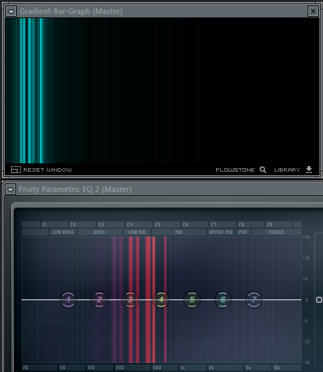

Wow KG, this thing is pretty. I changed the multiplier value going into the bar graph module to 0.05 for better visibility. I did notice the scaling seems a bit odd though.
FFT Scale.PNG (189 KiB) Viewed 24696 times
Even with the log scaling, the higher frequencies get a lot more space. Tried screwing with the math here but apparently don't know what I'm doing. Maybe it's a log base other than 10 on the PEQ2 meter?

Edit: Thinking the scale is log base 2, since that's what pitch is based on. How to apply log math to arrays though? I guess you'd just use Ruby for that too.

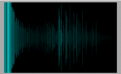

Hey look at me! I added alpha all by myself! :lol:
It's only for the background (min) color though (the "max" color is doing something else I'm not sure of with the alpha). Still useful. I mean that was the more important part. I blopped a background image in there just for demonstration.
Edit: Figured out how to set/scale the bar (max) alpha, but it's pointless here since it's just drawn on top of the background color with alpha in the first place. You can just scale the input values and it would do the same thing.

And just for fun...

Perfect Human Interface wrote:y look at me! I added alpha all by myself! It's only for the background (min) color though (the "max" color is doing something else I'm not sure of with the alpha). Still useful. I mean that was the more important part. I blopped a background image in there just for demonstration.Edit: Figured out how to set/scale the bar (max) alpha, but it's pointless here since it's just drawn on top of the background color with alpha in the first place. You can just scale the input values and it would do the same thing.
That gave me an idea. Look at new version at FSG http://flowstone.guru/downloads/gradien ... escription
The old version first draws the background color and than draw the bar color gradients, where the y value sets alpha.
New version with transparency support does not draw background. Instead it uses y values to interpolate between back and foreground color.
I've kept the old version too, because it's lighter on CPU.
Also I've found what was causing the bug with those one pixel lines in the bar graph. It was the gradient - sometimes the gradient wrapped one pixel early. I've changed the wrapping mode, so now when it happens it is not even visible (it possibly can be, if you'd draw so much bars they'd be one pixel wide... but that's ridiculous).
