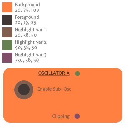

Let's imagine someone's preferred color would be a nasty orange. I know, who would ever prefer such an eye-hurting color? But still, let's just assume there would be one person in the whole wide world. How would the color palette look like if done similar to Sinner? Like so:
In this case the dominant color is also the lightest instead of the darkest, etc. Everything is reversed. And doesn't it look beautiful? Apart from the orange of course which is still burning my eyes...
Now that we have our colors, we can't just use them freely. Obviously, the dominant color can only be used for the background. The foreground color should be used for all elements' basic shapes (incl. text), and the highlight colors should be used to point the user to important parts (as the bars of the envelopes, or the sweep of the knobs).
So why did you use 3 highlight colors then, you ask? Because they point to different parts/purposes. While highlight var 1 is already explained, highlight var 2 is used only for switches, and highlight var 3 shows the elements that are modulated by the LFOs.
