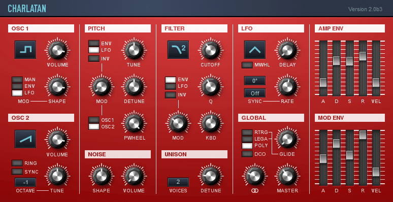

Often times there are technically brilliant Flowstone VSts, but people don't get attracted just because of a bad or quick designed GUI. Therefore I thought we could use this thread to post screens of well-designed GUIs, as an inspiration or maybe just to learn what distinguishes mediocre from brilliant.
The first screen is from a synth called Charlatan:
http://www.soundandrecording.de/wp-cont ... atanv2.png
Pros:
+ High contrast
+ Clean and tidy surface
+ Well structured
Cons:
- The glide part of the global section is a tiny bit too stuffed. A three-letter-naming would have been better

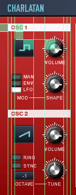

Graphic design is a serious job. It is all about symmetry. There are different kinds of symmetry, and people may have heard of the proportio divina ("golden ratio"), which is even very mathematical:
a : b = a+b : a
How well thought and layed out, and how symmetrical the first GUI from Charlatan really is, can be seen from this second picture. I added a few lines and squares to make it more obvious:
Btw, the small buttons are divided by the line at exactly a third - not a coincidence. And I'm sure the designer made the layout when he was told the texts besides the small buttons would all be 3 letters.
It's by far not all there is, but it gives you a hint to how many thoughts go into a good design. It is not just pretty knobs ;)
