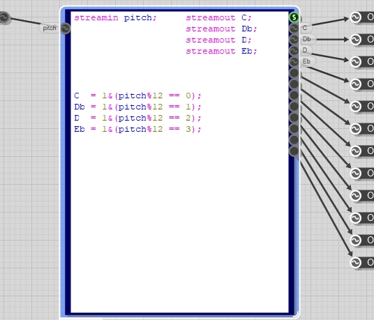

Earlier in the thread the "Note Equal" prim was mentioned. Not sure how the timing of that is.
Here is a little demo that switches at samplerate. Needs optimizing, I know. Is it helpful for your purpose at all?

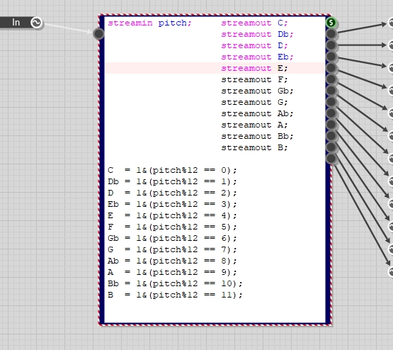

Re: Triggering switches with Midi notes.
This is excellent ! THanks.
I guess I neglected to mention that all tracks are meant to be stereo
I modified it a bit to handle that.
Seeing that there are no adsrs I might need a declicker as I will be switching a lot of bass:)
Also, it does not work in 64 bit alpha , the ruby script give me an error inside module?
Do you not have the alpha yet ?

It seems to be ok if I delete some the notes ?

I just wrote the code back into the ruby window and now it works.
