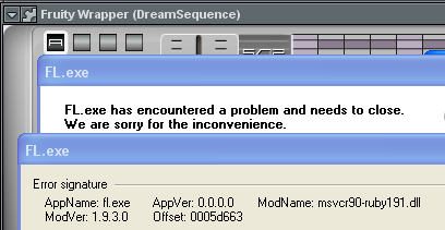

Latest dummy spit for ruby was in Fl Studio, when loading "DreamSequencer" by Nix.
This "DreamSequencer" is a Flowstone modified version.
It also crashed my soundcard in the process(everytime).

Support thinks your XP install is incomplete.
I am going to get as many people as possible to test the .dll .
It's a pain, you would love to try the new timers I'm sure.
If you can get FS up, I will pm u some tricks I have got working.
