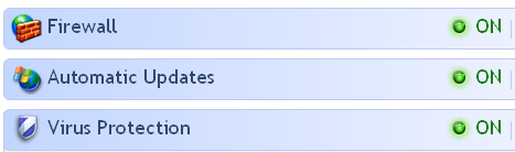

Hi Support, are you still there?
i had backed up ready for XP re-install/repair. Decided to poke around a bit more.
Download a fix online that got Microsoft Updates working again
. Fully updated System now,
using Zonealarm for Firewall & antivirus.
Flowstone still crashes !!!.
The only other problem I'm seeing is that my Desktop keeps getting "auto arranged" by something
(probably traces of Norton install/un-install)..tracking that bug now. If it wasn't for the
"Desktop restore" program by Midiox I would have kicked the crap out of this CPU by now.
And my CPU start up and shutdown times are far too long. So somethings still wrong,
even after all the Microsoft updates.

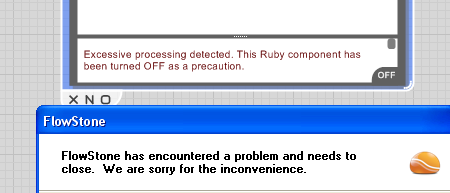

Open flowstone, dodge the error pop up, drag a "Ruby" module from toolbox and it says
this. (Note:Loading a Empty schematic) Hope this helps.....

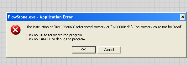

First: A couple of months back the same "msvcr90-ruby191.dll" issue turned up on the laptop.
When the same error appeared from SM- I ditched Flowstone from the laptop, and let FS go.
Now back on my main CPU,
I downloaded "Chief Architect", which uses the "msvcr90-ruby191.dll". No issues at all.
So why does Flowstone crash at start-up, blaming the "msvcr90-ruby191.dll".??????
I'm not convinced on the XP re-install theory- (due to the success running "Chief Architect")
As it seems to be a memory problem, would it make sense to load my CPU with Brand New Memory??
PS. have tried the new 3.01 FS Update. Same thing.
- Posts: 1161
Re: Crashing on start-up
Just an idea: search "msvcr90-ruby191.dll" on your computer and remove them all... then re-install flowstone
MyCo - Posts: 718
MyCo wrote:search "msvcr90-ruby191.dll" on your computer and remove them all... then re-install flowstone
tried it again. Same thing.
Outsim gave me that tip few months back, i went through it all- \system\32, Registry, Docs and Settings/program Files. Didn't solve it.
And "outsim".....Please exuse me for keeping this "negative" post alive. It's just the best bug I've ever come
across. Can't resist the challenge...you know...
