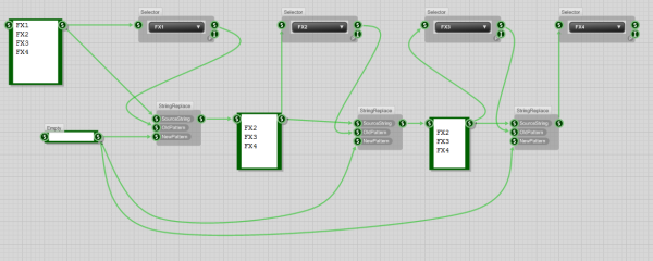

I'm building a semi modular effect. The user can select an effect on every slot, but when an effect is chosen, then in the other effect slot must the effect removed. I'd build some logic, but I have empty places. How can I remove them?
See my schematic
SelectFX.fsm

I found some ruby code online. Seems to work. Try out the attached module.
SelectFX2.fsm
(2.37 KiB) Downloaded 1147 times

I would do it like below, all one line and no extra bits required ;)
output @SourceString.gsub(@OldPattern,@NewPattern).each_line.reject{|x| x.strip == ""}.join
SelectFX remove empty.fsm
(2.24 KiB) Downloaded 1157 times

Postby Yuroun » Wed Apr 10, 2013 3:28 pm
Thanks Guys. Both are elegant solutions. I prefer the version of Jay. He modified my Ruby code nicest ;)

Here's the version I had in mind. It's not working perfectly :roll:
SelectFX.fsm
(2.55 KiB) Downloaded 1160 times

yeh its just a saying Yuroun :D a bit like "well thank you very much"
I see what you mean about not working perfectly, it seems the last column does not always update properly, I will have a look at it and see what i can come up with :)
