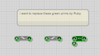

Hi all. I want to improve the time precision of a complex step modulator made with DSP code and green prims.
Does anybody know how to make Ruby codes to replace these green trigger prims?

Here you are. However, it doesn't make sense, since you convert from green to Ruby, then back to green. The unreliable timing of green stays. And the overhead will probably make it more CPU intensive.

Thanks Tulamide! I understand the reason why it has no sense if I use them in an isolated way (that´s, a Ruby module with just that small code). Perhaps if I add that code in several already existent Ruby modules on my scheme, so to avoid go and back to green, it may make the difference... I will try.

When only having a line of code (or several) that will be executed whenever the RubyEdit gets triggered, you can omit the event method definition. I wouldn't advise it though. Read chapter 8 of the user guide, it is a treasure for questions like these!
