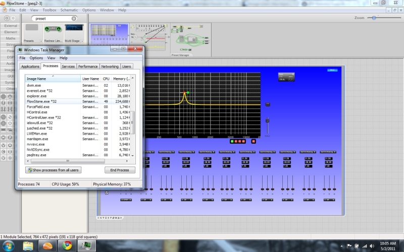

Hi,
1. I have problem with CPU usage in my project,
why the CPU usage is so high even without play around with it?
do you have any suggestion? please see the attached below

Use the redraw area primitive and only one for the area is needed. Also make the redraw area small as possible and keep it on default zoom. It's a very big area to redraw and the solution is not to zoom out, but make the area smaller instead.

1. I have v1.1.3. to work fine. Press CTRL + Shift + Alt + T and be sure the new trigger system is activated.
2. A image will only cause high cpu use if you're redrawing a big image very fast. Memory use would be the same as the size of the image.

Maybe I'm being a bit dim here, but I can see what your project actually does?
You seem to have two banks of EQ's but only acting on Floats (Green = slow)? If it's audio ( I see you have 20hz - 20Khz) you want to process then you need to be using Real-Time (Blue) connections!
Also you have some buses that get extracted and switched then re-combined, I would just use a sector to switch the whole actual bus.
