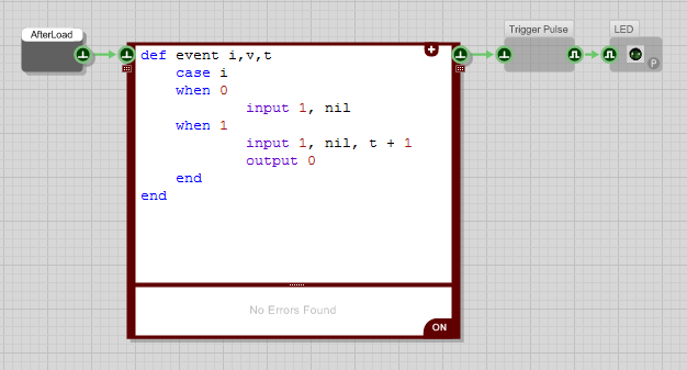

In fact, it could be, so maybe you understand more than you give yourself credit for! It just has to be a number bigger than the last "real" input (100 actually wastes a bit of memory in the RubyEdit, because the array of input data [@ins] takes up space for the missing inputs 1..99).
Alexandre wrote:Funny that the input cannot be 1 on the example above (has to be 100, or 10, or 2, but not 1)
Re: Ruby Ticker
Just for clarity: It can be any input that is not used already. So, if you have 2 inputs in use, index 0 and 1 can't be used, but index 2 would be available. In the DSPR modules, a high index was chosen probably to prevent any multiple use of an input (a user might add inputs to extend functionality, etc)
Re: Ruby Ticker
Yes, now I got it, 100%
Thanks trog and tulamide!
Simplest possible Ruby ticker below.
