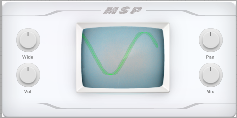

Re: Bedini 3D Audio hardware was recreated with synthmaker??
Hi guys!...
I started doing UI plugin for MSP,
I want to make krkativnuyu graphics vintage design, a long time I picked the color, but the result did not impress me, I plan to continue to create UI and will seek the best, until you do a superb view!
Here is what I came to do last night ...
DL Skin:
I love this screen, and white tones, but do you like it?
Or do you want to see the slim design?
DL Skin:
