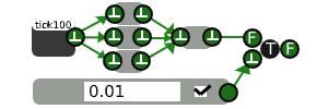

Well, OK smart guy. here's a perfect tick 100 using both Ruby and Prims. You see? People talk and talk and talk. Innovate. Nonsense, all nonsense. Don't talk, innovate.
At least a bit of negativity keeps Me sharp. And in the case of Tula, he guesses a lot and he likes being negative. I get it. That's part of his personality.
So, tomorrow I'll upload this new example that works 100%, here it is in image form. Doubters, foolish doubting the skills of King OZ, lol.
That's why I do this commercially.
Follow the instructions in the image and it's 100% perfect. No more ruby CPU sputtering and 2% spikes

The "people enforcing a status quo" around here are Spogg and myself, and if you think that this status quo "doesn't work" then you are not obliged to post here. Otherwise, please refrain from personal attacks (you can hardly deny it; you even used the word "personality" in your comment about tula). Since you have so blatantly encouraged criticism with your boasting, I do not deem that (so far) anyone has unfairly attacked you (though I do remind everyone else to play nicely, whatever the provocation).
Ultimately, this is a technical forum, not a sales and marketing convention, nor a personality contest. Your commercial success and witty repartee count for little when your schematics are being judged - they will be criticised or praised based primarily upon their usefulness and technical merits. Be warned however, that "perfect tickers" have been presented every few months ever since SynthMaker was first released over a decade ago, and we have become rather expert at debunking them over the years. Chris has done a sterling job of explaining why it is believed impossible, and this is based on sound empirical experiments and computing theory, not just common or garden dogma.

I am calm I have customers and I don't have excuses for them. Like in the image posted above; (if you had tested instead of being so negative) you'd realize that I've now succeeded and it works.
It makes no sense to be so negative all the time, it achieves nothing. Look inside this new schematic and you'll see that it gets exactly to 100 each second, never more never less and of course it doesn't spike at all which is great.
