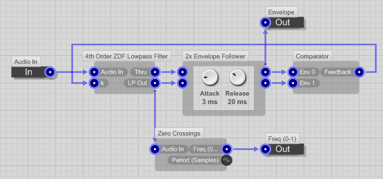

Re: frequency readout
Spogg, I had this schematic lying around which does pretty much what you describe. It uses a tunable 4th order Butterworth lowpass filter, a dual envelope follower and a comparator in a control loop setup. The lowpass cutoff adapts to the spectral content of the input, such that the amplitude is reduced to 70%. That's a higher value than your 5%, however it provides good results with my (steeper?) filter. There are other adjustable parameters in the loop which one can play with, and as you point out the feedback timing is crucial. The lowpass output is then analysed for zero crossings, using linear interpolation for subsample resolution. All in all it works reasonably well, not great.
AdaptiveLowpassPitchDetection2.fsm- (16.81 KiB) Downloaded 1250 times

Wow Martin!
That's a great piece of work and so much more than I'm capable of yet. Worked straight out of the box.
Many thanks for sharing this.
I shall study it and hopefully learn something
