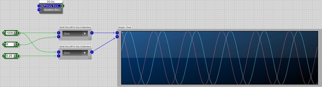

My setup is using them in quadrature, but I have noticed something when using these oscillators, the phase seems to drift...
For example if I set the phase of 2 oscillators to 0.00 and 0.25, initially everything is fine, but after a minute or so the phase drifts. It matters to me only because I want to use these oscillators for drawing a circle or other complex shapes, and if the phase drifts the "Spiro-graph" (for lack of a better term) also drifts and the image is not symmetric anymore. I have been using Flowstone (and Synthmaker) for the past few years drawing shapes and patterns in laser (think o-scope).
Here are some images of the issue and the FSM file. I am using 3.0.5 Amber.
Here is the FSM file as well...
Possibly a numeric precision issue when calculating the phase and or frequency(?)
Thanks for any insight into this or hopefully a fix,
Aron

Yes, I see where's the problem:
Note, this is the code version of what's happening under the hood in assembly.
Notice, when "ramp" is of several orders smaller than phase it looses precision when "ramp=ramp+phase" and later "ramp= ramp - phase". This is often use in denormal protectors, to round very small values to zero (basically rounds the value to certain number of decimal digits), but in this case it does harm, because when ramp is very small (and increments in very small steps = LFO) it gets rounded by different amounts depending on size of "phase".
FIX:
This will add the differential of phase to the ramp ( = when phase changes, the ramp changes by that change). Martin if you're reading this, please update your osc schematics.
//calculate ramp:
ramp=ramp+ phase + freq*0.5 ;
ramp2= ramp % 1; //this is for float numbers - the remainder may (and is) a fractional - not integer.
ramp=ramp2-phase;
out=sin1(ramp2);
FIX:
//calculate ramp:
ramp=ramp+ (phase-Pphase) + freq*0.5 ;
ramp= ramp % 1; //this is for float numbers - the remainder may (and is) a fractional - not integer.
out=sin1(ramp);
Pphase=phase;

Correct, there is a phase drift due to floating point arithmetics. I have a fix using fixed ponit arithmetics but it will take a while to update all schematics. In the meantime, use the dedicated quadrature oscillator in my schematic at download/file.php?id=3797 where the relative phase does not drift away from 90 degrees.aronb wrote:My setup is using them in quadrature, but I have noticed something when using these oscillators, the phase seems to drift...
