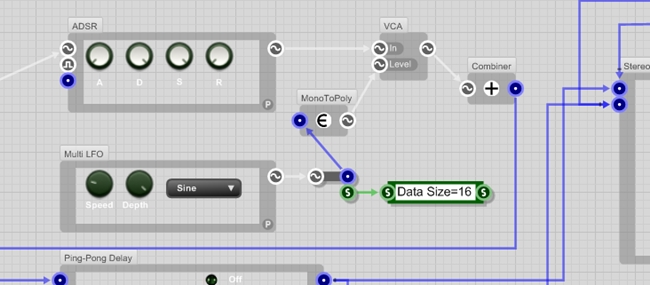

This is what I am trying ....this just kills all sound
- green.jpg (109.16 KiB) Viewed 25629 times

You are still doing it wrong. Your lfo is still white, then you change it to blue, and white again. Connect the lfo directly to the mono to poly, so the lfo is blue, then you can connect it when its white.
