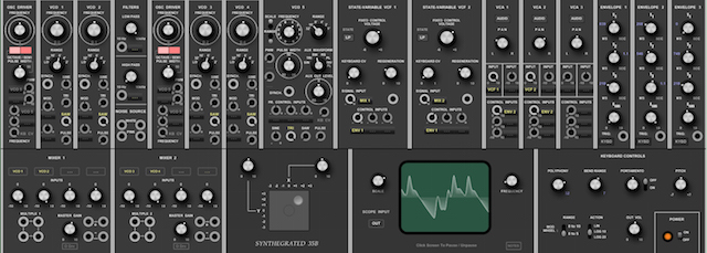

Synthegrated 35B:
Called 35B because it's a very slightly incomplete emulation of the System 35A, which was the System 35 without the Fixed Filter Bank.
Five oscillator beast!
Synthegrated 35B:
