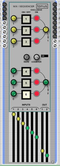

Hi all you Flowstone Gurus out there (in here?); up to now I've tried to avoid asking for help actually building something (well except for hinting that someone pitch in with the Buchla Source of Uncertainty and sequencers), but now I plead for assistance with something that I just can't get to on my own.
I've been pretty happy with the progress I've make with the ARP 2500 emulations, but a couple of the systems I've assembled really are in need of mixers. The only one ARP ever made for 2500 was the 1050 Mix-Sequencer. Building the mixer part was no problem, but the 'sequencer' function has got the best of me. The 1050's sequencer function was not a sequencer in the usual sense - it didn't generate a series of control voltages, but rather switched a series of audio inputs on and off in sequence at up to audio rates. So clearly the answer can't be found in the various SM/FS Step LFO/Trance Gates that have been built. Using stream-to-floats to switch selectors on/off is very clumsy and at rates above a slow clip-clop it has two left feet. I don't know if this can be done with greens somehow or requires writing code, but trying everything I know how to do has gotten me nowhere. Before giving up and just using my Mixer-only version, I thought I'd put up an appeal here.

An example of an assemblage of modules that could really use a mixer:
The only mix function here is the four-input mixer in the 'Filtamp' (VCF/VCA); one could use those up pretty fast.
My stumbling attempt:
Only three inputs per mixer, because in my emulation of the switch matrix, only eight switch positions per module fit. The 1050 had eight inputs and two outputs; the 2500 had 10 switches per module slot.

Maybe have a look at the fast mixer in my Quilcom NINE?
This uses a changing level (e.g. ramp) to do a linear cross-fade between 9 successive inputs but is easily adapted for the operation range of each stage. It runs at poly stream rate and of course is not limited to audio. Martin Vicanek kindly did the ASM optimised version for me.
Maybe this could be adapted. Of course it's made with Flowstone, but the ASM module code is the important part.
Just what are you able to do with the FS demo now that the time limit has expired?
