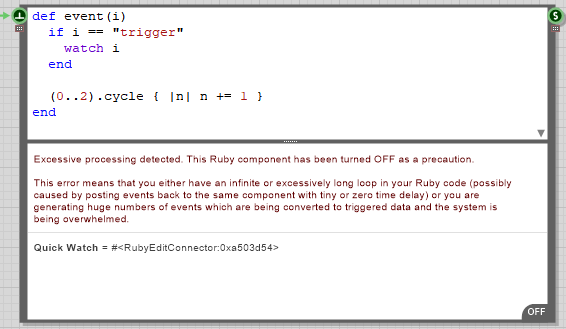

6) This is the most challenging point for people, who never programmed before, or only in very, very old languages. The watch method does not immediatly print on the info pane! Instead, it only updates its hash table, and waits for the full execution of the method, where you used 'watch' in. Only after the method returned is it that 'watch' actually prints out to the info pane. Please spare me to explain in detail, why this is so. Just accept it. Here's an image, that might make it more obvious:
So, what has happened here? The method consists of two parts.
The first part checks if a certain input was used to trigger an event, and orders 'watch' to print the input class on the info pane.
The second part is the mean thing. It is an endless loop. I purposely prevent the event method from returning. If you would execute that code (please don't, you have to close and restart Flowstone afterwards), you would see that the info pane stays clear. Then the Flowstone interrupt function breaks the code, returns from the method, writes the error message, and finally the watch hash table gets printed on the info pane. Exactly in this order.
Once again, no printing occurs, before the current method has returned! This also can let you run into issues. For example, if you run a method that uses the watch method and then calls another method, where another watch method call is made, the order will be reversed to what you'd expect. You will see the second method's watch result printed first (because this method has returned to method 1), then the first watch method's result. Take care of proper naming, to instantly see what you are presented with.
