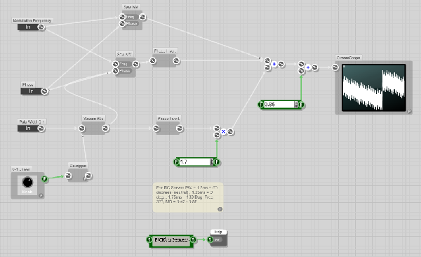

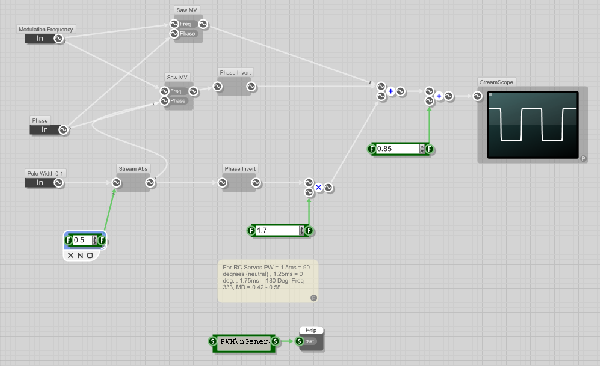

Postby k brown » Thu May 03, 2018 5:24 am
mv pwm2b.png (33.19 KiB) Viewed 27472 times
mv pwm2.png (35.67 KiB) Viewed 27472 times
mv pwm.png (42.02 KiB) Viewed 27472 times
Is there another way of doing PWM? - these are the only two I know of. How are you doing it?

Postby martinvicanek » Thu May 03, 2018 7:51 am
Sorry your images came out pixelized. Anyway, here is a little demo, hope it helps.

Postby k brown » Thu May 03, 2018 4:15 pm
Thanks for that, but I can't open the schematic I only have SM. I tried combining the saws with a stream subtract but get the same thing you see in the images I posted. Is your Phase control just a 0-1 de-zipped knob? And the Multiply module - just an attenuator? Is there anything in those Saw modules other than the code itself?
In general, is there an advantage to doing PWM with a steam subtract rather than mixing the phase-shifted saw through an inverter?
About the images I posted - there must something I'm not understanding. When I try to post larger, higher-res images I get a warning that they must 600 pixels on the largest dimension.
