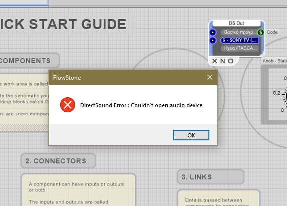

Postby ChrisPap » Wed May 16, 2018 11:39 am
Thnx for support Spogg ,look the pic ,I cant work anymore with direct x device, only with asio
Direct x don't open
2018-05-15 (2).png (46.04 KiB) Viewed 16281 times

always I work with direct sound ,but and asio ,after setup to my pc, last April Microsoft update start the problem .Direct sound driver don't work with this program in my pc. No background app running ,only FS run and again I have problem with DSout ,can't play

SONY TV support Dx don't have problem, is the hdmi .DS is the default driver in flowstone and can't open to listen audio
The most samples from the forum they have as default Ds out .Now if I want to listen some new vsti need to remove Ds out and add asio ...and many clicks to unblock the program
ds don't work
