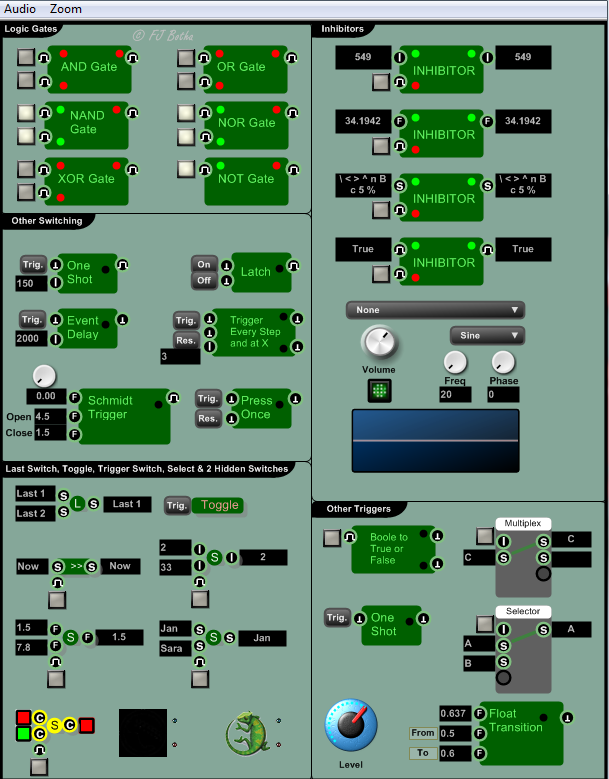

DIGITAL LOGIC v3 (Picture Only):
The image shows a picture of a real working *.exe programme I made to mimic Flowstone components and to show the components and their action as well. For instance, the Multiplex and the Selector on the drawing actually shows the connectors switching just like you would see in a schematic thereof. This is time-consuming as you have to draw each component and each of its connectors and all the connections to the individual connectors, in order to be able to see it on the display of a *.exe programme, as the real/actual components and connectors once exported to a *.exe file will not show up. Then in the background, I still used the actual Flowstone Components to do the actual tasks.
I made several such programmes as teaching aides only but oh boy this is not only a lot of work but it also becomes spaghetti...
- Digital Logic v3.png (116.6 KiB) Viewed 23066 times
