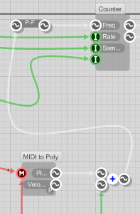

I'm trying to figure out how to trigger the wave to play using the stock "Wave Player" module... haven't a clue what's going on. :( I don't even know how to get the darn connections out of mono and into poly mode.
Now I keep trying to strip down this "drum pad" schematic that someone else made to upload here as an example of sending a trigger to play the wave, but every time I cut out the module and paste it into the top level it just stops working... even after undoing. :?
Anyways here it is a couple modules deep. I don't understand how this works. If you open up the "midi to poly" module you can set the number of voices to enable overlap though.

Shouldn't you add there "midi in select" module, connect it (red wire) to the place where you have inactive wireless connector, and select at least a PC keyboard?
BTW, bcause I see "not" prim floating free. If you want to use boolean true/false options, then there is a green boolean switch to do this. "not" prim just inverts what comes in (if nothing connected, then input = 0; so by default it outputs 1, not "not").

What I just uploaded was something I ripped out of another schematic. The point being that chunk of components does what we're looking for (just click the trigger button I stuck in there), so if someone can wrap their head around that better than I can maybe that example will help.
Oh dammit. I just tried opening that schematic in a fresh project and now (again) it won't work. I'm sorry guys, I think FS is just plain broken here.
