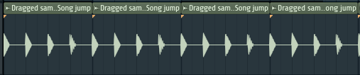

Postby MyCo » Sat May 18, 2013 5:49 am
I can't believe that I'm still wasting my time with this stupid bullshit. I haven't found a "green timing" in the timing thread, so I thought I just break something just for fun. So I took your "X11 2.01_v3_Timer.fsm" and exported it as VSTi. Since there is no PPQ the breaking task wasn't that hard. I've just set an unquantisized Loop end, and after the first runtrough it was completely out of sync.
Here is the FLP with the looppoints and the VSTi DLL
This'll happen with "Ruby test_0_with PPQ_Myco style.fsm" and "Ruby test_0_with fL CLOCK_4.fsm" and some others, too
simple test.zip
(1.85 MiB) Downloaded 1047 times
