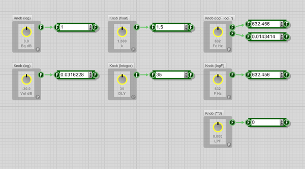

I'm posting a .fsm containing a few knobs derived from Nubeat7 initiative, no more Trigger Galore, debugged by MyCo. They are all different, featuring different transfer functions. In the properties you can change the colors and other details. I wanted them to be as simple as possible. There is no MIDI support.
knobs properties.png (31.1 KiB) Viewed 29515 times
knobs (Nubeat7 steph_tsf MyCo).fsm
(6.56 KiB) Downloaded 1431 times

thanks steph! very useful transfers, after u figured out the redraw issue, u saved my last project, i already was wondering why the readout was looking so crappy when in use :D, i also know now how importand it is to watch the task manager from time to time :lol:
